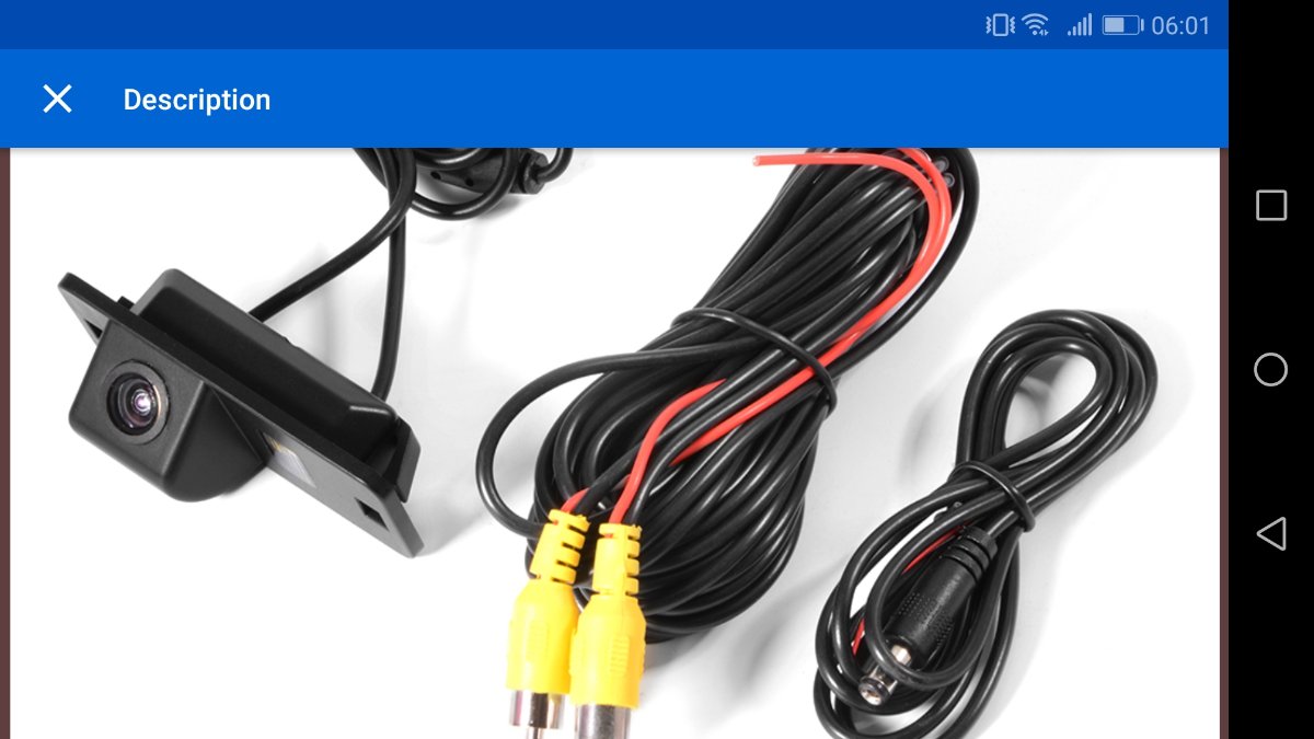

Post by Themoog2 » Fri Apr 26, 2019 6:03 am
This is the camera

Post by sleepyfolk » Sat Apr 27, 2019 1:33 am
Don’t want to be a party pooper but when I did mine and looked at these number plate light replacements it seemed at the time there was a lot of comments about them causing dash errors with the lighting self check system so I went for one built in to the number plate.
Anyway, when I did mine I took power from a switched supply from one of the spare relay slots on the right hand side of the boot behind the panel where the sub is, put a fuse in line and earthed it just above the rear lamp cluster. The signal wire on mine which I think might be what your little red wires are - one end connected to the reverse lights ( by tracing the wire back into the boot area and splicing in), the other end went to the “reverse signal” wire dangling out of the replacement stereo.
Might help if you post the wiring diagram even if it’s a bit chinglish.

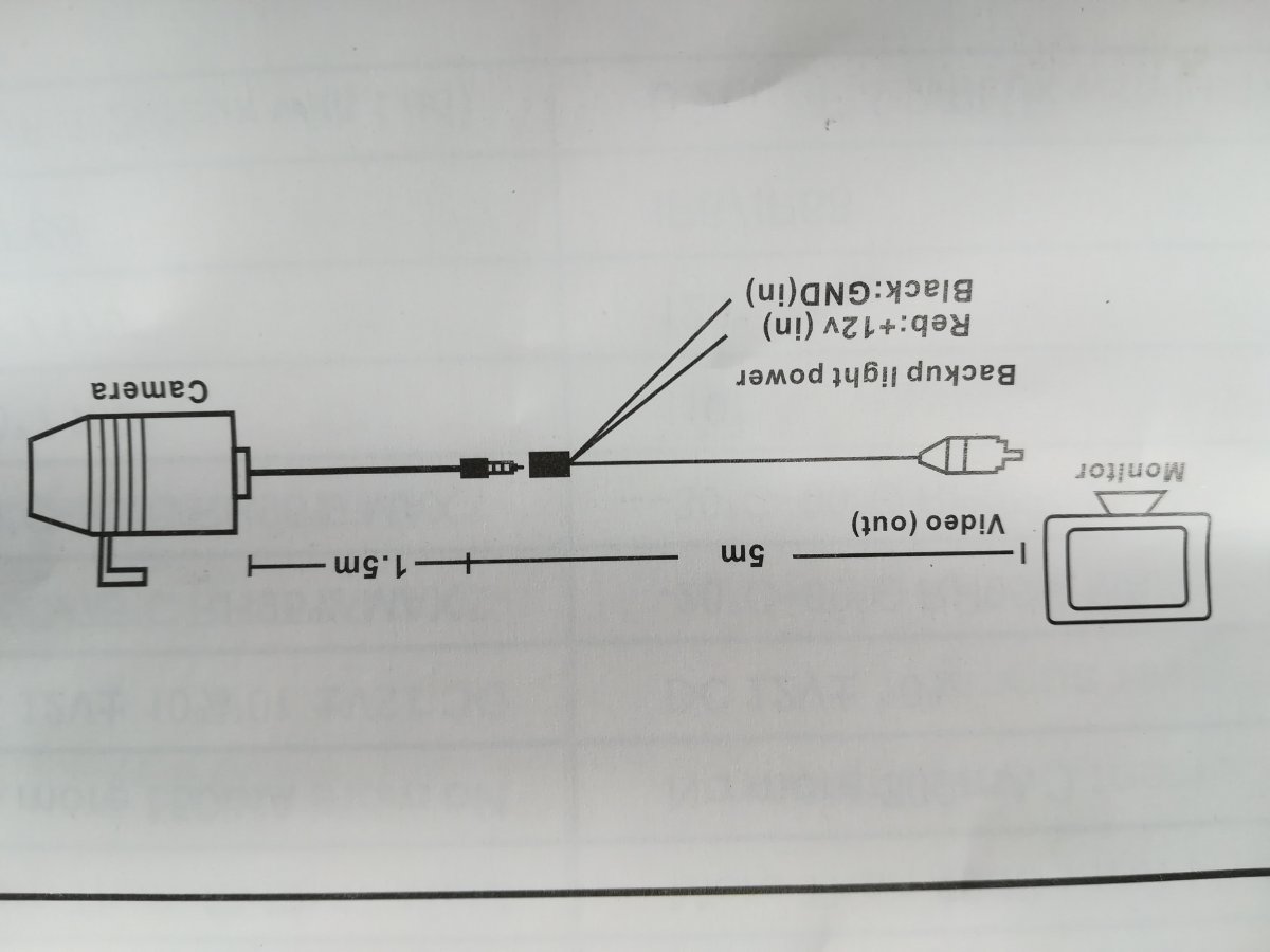

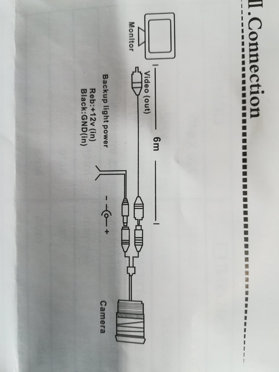

Posts: 595
Location: Cambridge
Re: Reverse camera install
Post by Themoog2 » Sat Apr 27, 2019 11:47 am
Diagram..
sleepyfolk
Posts: 452
Post by sleepyfolk » Sun Apr 28, 2019 12:00 am
Can’t say that it helped me! Did you get it put in?
