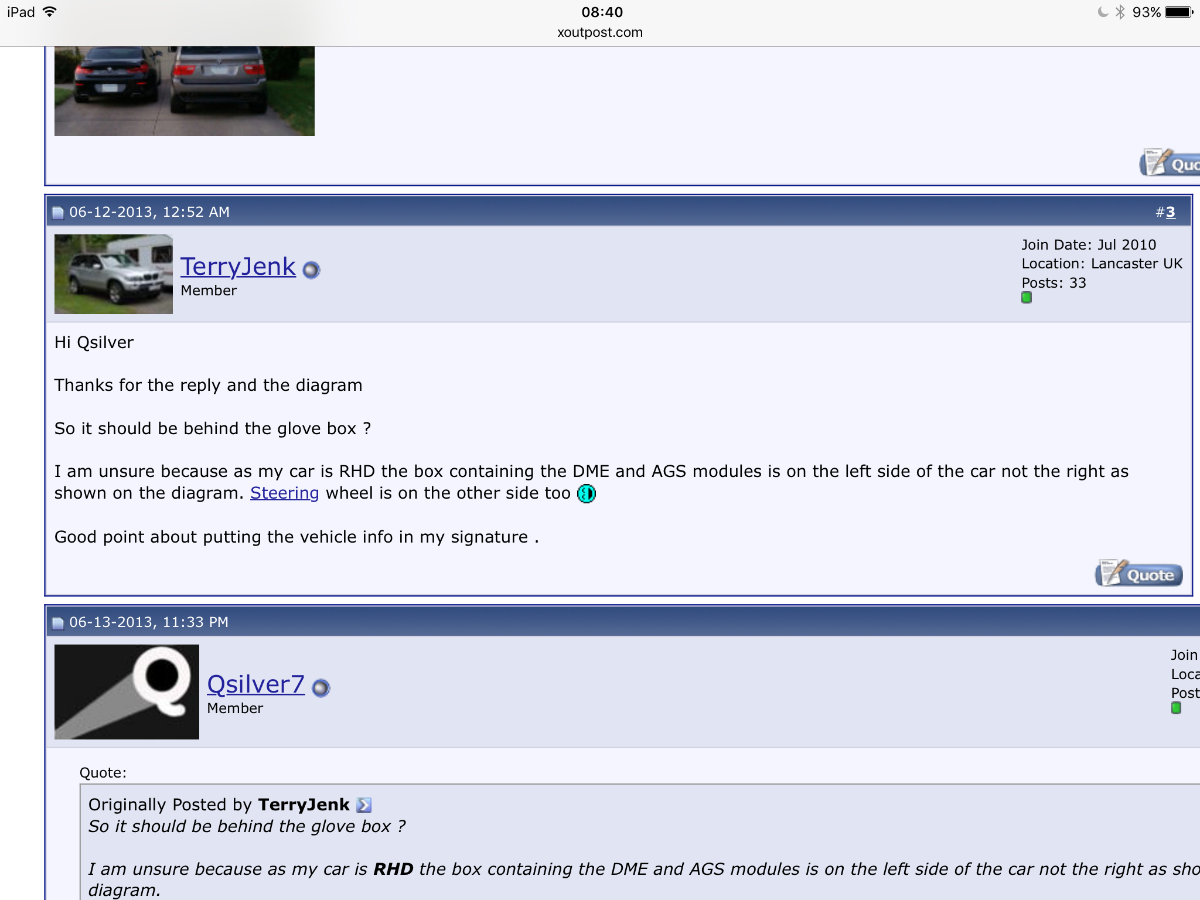

In the driver's foot-well according to this have a look it might help.(last post No4)
https://xoutpost.com/bmw-sav-forums/x5- ... ation.html

Re: Position of EWS module in an 2004 E53 4.4
In post #3 in the outpost link it says on the RHD ars the module is on the left side, not the drivers side.
