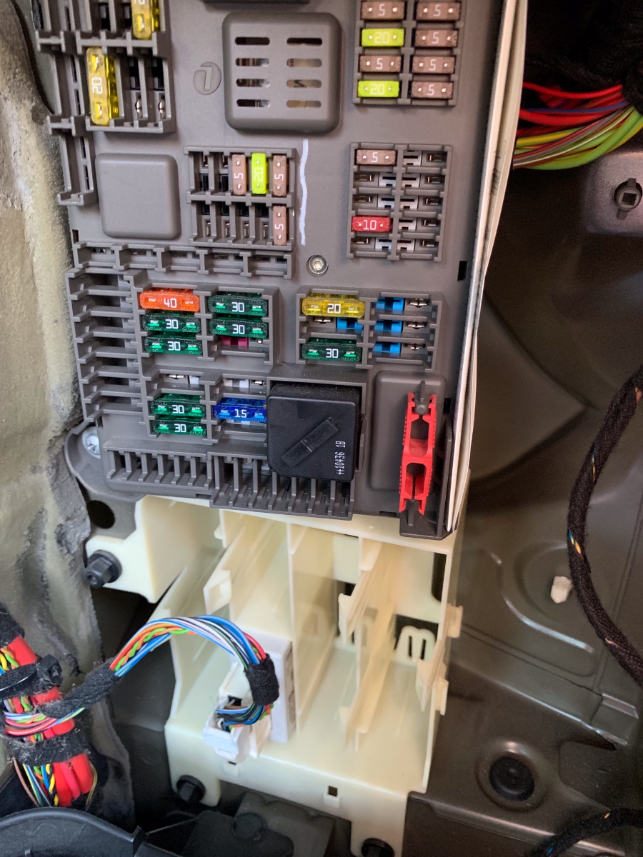

Do you know where is the PDC control unit located? Everything online is saying that it's on the right hand side in the boot. Just underneath the fuses there is white plastic holder where it should be, but I only have there the air suspension control unit :?
IMG_0962 copy.jpg (381.97 KiB) Viewed 14370 times

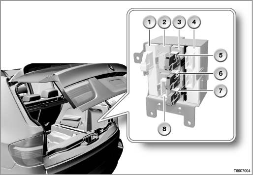

For the model years 2007-2008 (and possibly part of 2009), the PDC is a separate module located in the right rear compartment, below the A42 rear junction box, in a white, plastic rack.
