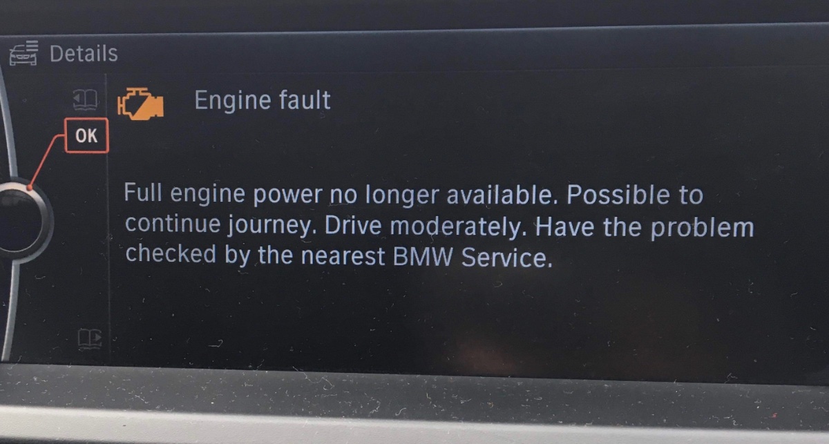

So for some time, when the morning is cold, my car can run a bit rough for the first couple of hundred yards(happened a few times). Start and idle is fine, it's just when driving it feels like its going to die and yesterday morning it just died with following error message on iDrive. When started the car again it ran really smooth and everything seemed fine - no loss of power or other symptoms. Also this happens only in mornings with lower temperatures, during day etc is all fine. Carly scan is below - any idea guys?

Re: Engine Fault
What’s the Carly codes on the engine/motor.
Have you scanned in on ISTA-D?

Re: Engine Fault
494A
This is combustion preheating control unit.
It could be your glow plug controller is playing up again but I would scan using ISTA-D.

Re: Engine Fault
The only other code I'm getting is Info on the DPF which is there due to high milage. Unfortunately I don't have anything else apart from Carly ... will have to book it into the garageAdamsX5 wrote: Tue Mar 19, 2019 6:54 pm What’s the Carly codes on the engine/motor.

Re: Engine Fault
Take it to a specialist as dealers will
Charge you 120 for a simple scan.

Re: Engine Fault
So I went to my local garage on Saturday and their scanner show some error on EGR valve - however they said that they can't confirm and further diagnostic would be needed (or inspections).
I think I'm going to look into the EGR valve and see if it can be cleaned – anyone done this (not using the fuel additives but the actual EGR cleaning)?

Re: Engine Fault
Egr cleaning it easy I cleaned mine (35d) and my previous 535d. Get some cleaner from halfrauds, it's 4 alen bolts holding the egr on and a circlip connector.
