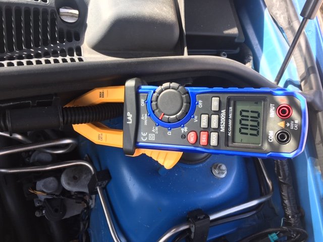

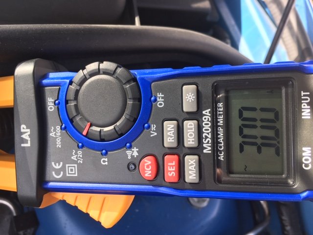

Just done a very quick check with the clamp meter, first picture shows with engine running
Second shows with the engine is off.
I then thought it might be a dodgy bonnet sensor or something, so I set the alarm with the bonnet open and nothing happened, as in, no warning etc. Should there not be a warning to say something is open.
I did the same with the door, set whilst it was open, same, no warning .
I then alarmed the car and opened via the key and the alarm sounded as it should.
I find that all a bit strange that I'm not getting a warning about something being open.

You might have to get one of those adapters so you can check the current draw on each fuse way, after the car has gone to sleep after 16 minutes.
I take it the little orange light by the gearstick does go out?
I think X5Sport might know about how to do it, I’ve defined seen it described on the forum before, there some way of doing it without waking the car up I think
Not sure about the alarm thing to be honest, when I locked mine with the bonnet open and the charger connected I don’t think it made any objections or warnings

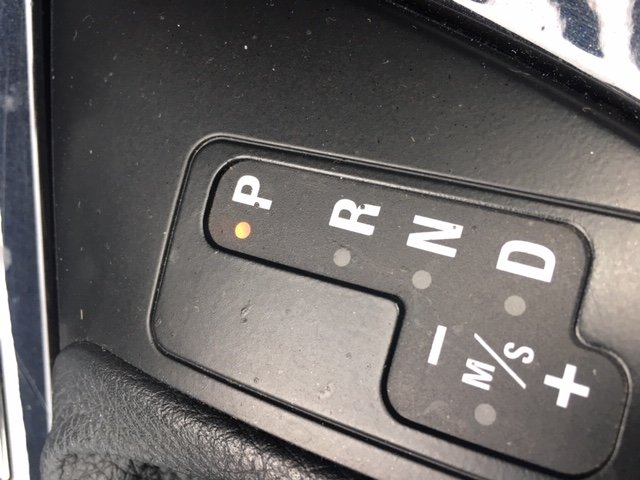

Do you mean this light?
How long before it should go out?
weirdfish
- Posts: 637
- Location: Glos.
Re: Battery drain?
Just checked and the light is out.

Yes, It goes out after 16 minutes- that’s when the car is asleep, and you should be down to something like 0.1a current draw if I remember rightly - don’t quote me on that number though!
