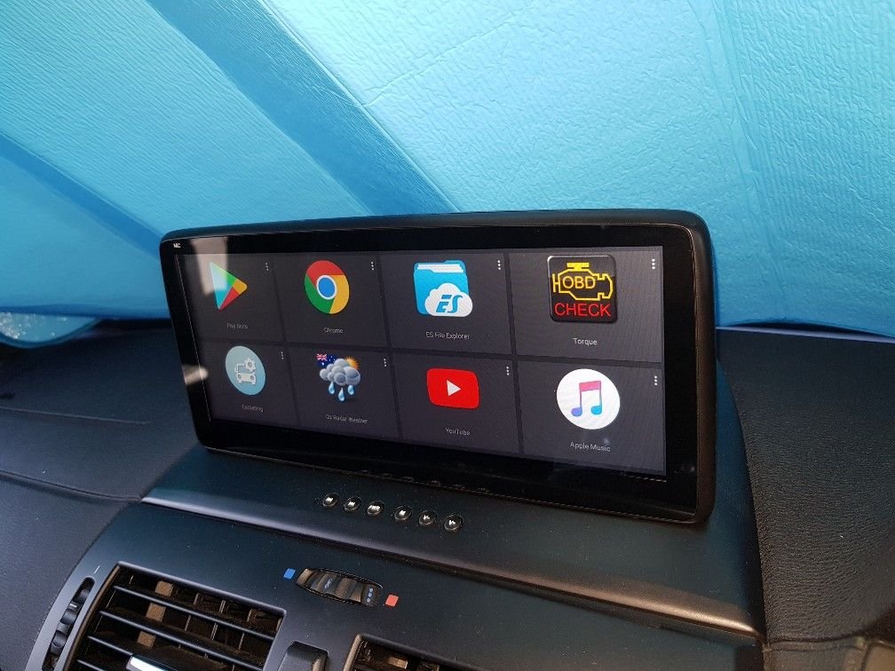

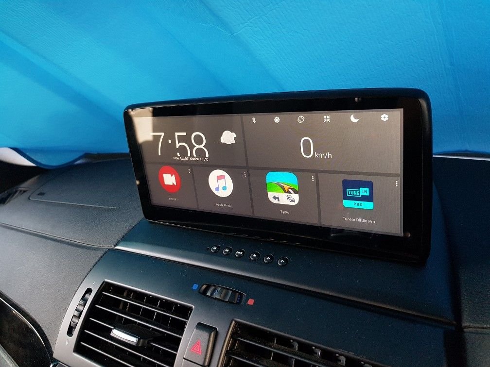

I went down this path about 8 months ago. Some initial teething problems and steering wheel buttons don't do all functions, but volume up down does. I did not use the bluetooth for phone calls option with the unit, because it is very average, plus the microphone is on the wrong side for right hand drive cars. I am using the factory bluetooth for calls, and the steering wheel buttons have the original functionality. The launch screen I am using is not the unit's default, it is one I got from the play store. Has internet connectivity via a LTE (4G) wifi USB modem fitted to the rear cigarette socket.
