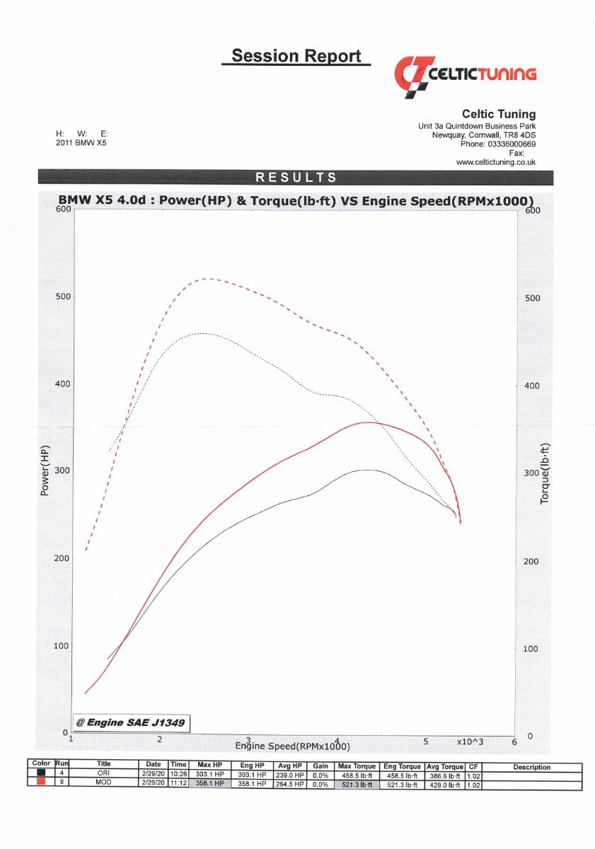

Funny you mention the hills... i was happy with the power until today when i over took a slow lorry up a hill and thought .. ok, i could just do with a bit more power.
I am not too fussed about the extra MPG but definitely interested in the power gains.
Do you have a before and after comparison? What sort of remap did you have?

I have attached the graph print out from the remap. It was done by Celtic Tuning on their rolling roads, they also did my last 525d touring.
Basic figures:
BHP - Original = 303.1HP Remapped = 358.1HP Increase = 55HP
Torque - Original = 458.5lb-ft Remapped = 521.3 lb-ft Increase = 62.8lb-ft The only downside was the large increase in Insurance but the grin factor already ahs paid for that.
You will also notice from the graph the change in the flow of the lines from low down making it overall smother through the entire rev range and "push you into the seat" torque.
