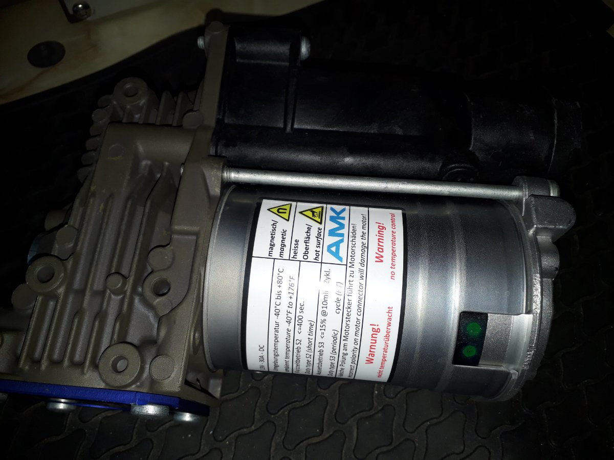

Well I received my pump this morn and when i went to fit it there are no threads to mount it to the bracket someone has forgotten to tap them and my studs seem to be m7 not the m8 I expected so even if the holes were tapped they wouldn't fit . The pump I removed was an aerosus aftermarket pump .
This pump in the pic is supposed to be a genuine AMk pump .
- Posts: 1673
Re: Self levelling system failure warning.
It has AMK cast into the end and the plastic so looks right ! Anybody else had an issue with these studs before ?
- Posts: 1673
Took the cover of the old Aerosus pump and going by the dent in the lid something has been in there that shouldn't have been and has made a mess ! No date on it to say how old it is .
I've contacted the seller of the AMK pump and they say none of them come threaded when they are new , anybody else found that ? He is sending me some used mounts as the Aerosus ones are too small a diameter ,look like m7 not the m8 needed. If the old one had been an AMK pump I wouldn't have this issue , doesn't always pay to go oe lol

I got the pump fitted this evening after nightshift , I did use a bolt to initially cut the threads and then the studs bolted up fine once they got started, I had an m8 tap but it wasn't m8 in the end. All seems to be working fine now and suspension level error is gone and rear is pumped up again.
Not much fun fitting this in the dark with a torch on the street though
No idea when they don't tap the holes at the factory maybe its to show a pump is new as you can't fit it without tapping them ?
I did run the pump with the 2 lines of the solenoid for 20 secs to blow out anything that may have been lucking there Incase it got back into the pump later as something clearing got squashed by the piston and put the nice dent in the top cover you can see in my other pic. I didn't find anything in there when i popened it so an worried where it is now !
