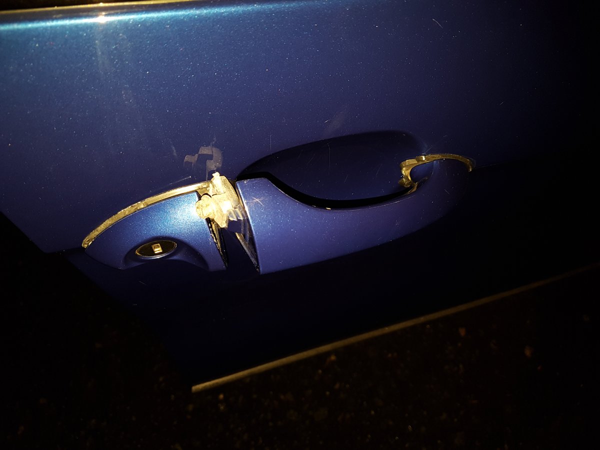

Door handle kaput
Post by Murphybarnes » Mon Dec 17, 2018 6:19 pm
Came away in my hand. Can still exit the vehicle just not enter it. Is this a carrier replacement or is there other bits involved?
Posts: 591
Location: Cambridge
Re: Door handle kaput
Post by Themoog2 » Mon Dec 17, 2018 8:58 pm
Looks like a new carrier required to me. Easy peasy. £20 tops.

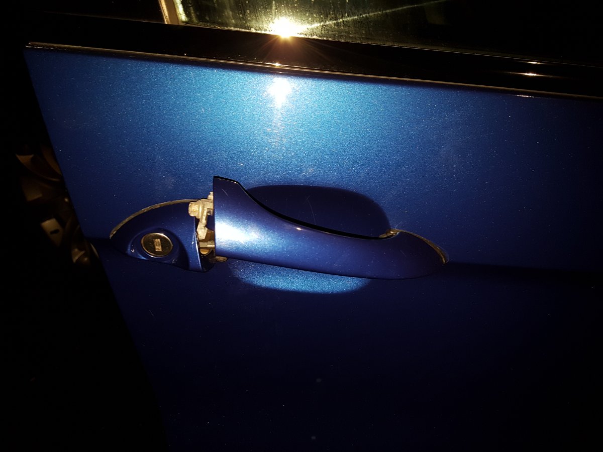

Post by Murphybarnes » Mon Dec 24, 2018 5:56 am
It's the piece of metal here that broke. Is this part of the carrier assembly?
Posts: 1484
Post by Alan Gunn » Mon Dec 24, 2018 9:41 am
Yes that is part of the carrier .
The 10mm nut on the end of the handle is the connection undo it and turn the handle round to 6 oclock and it will come off.
Murphybarnes
Posts: 110
Joined: Wed Oct 12, 2016 7:07 pm
Post by Murphybarnes » Mon Dec 24, 2018 9:46 am
Ok thanks. I do not have the carrier yet. I removed the 10mm nut to get the handle flush and back in place until I repair it. Unfortunately I dropped and lost some sort of metal sleeve from around that area and hoping all parts come with the assembly.
Posts: 1484
Post by Alan Gunn » Mon Dec 24, 2018 10:18 am
The only bit you need is the 10mm bolt in the end of the handle and nut the rest comes with the new carrier.
