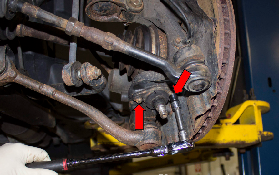

I did try and move the arm at the ball joint when it was last jacked up and couldn't see or feel any movement. That said, none of the front arm arms/bushes and links look recent and are probably quite old. I have seen a number of complete kits on eBay but unsure of the quality of some of them.Alan Gunn wrote: Fri Dec 07, 2018 7:27 am I had a wobble but it was a lot worse going round a long bend but did get it in a straight line.

Re: Yet another steering wheel wobble issue
It was the joint with the 2 bolts if you know the one i mean not on the arm.mr angry wrote: Fri Dec 07, 2018 8:53 amI did try and move the arm at the ball joint when it was last jacked up and couldn't see or feel any movement. That said, none of the front arm arms/bushes and links look recent and are probably quite old. I have seen a number of complete kits on eBay but unsure of the quality of some of them.Alan Gunn wrote: Fri Dec 07, 2018 7:27 am I had a wobble but it was a lot worse going round a long bend but did get it in a straight line.

Mine was hanging almost apart but other than the wobble no sigh when driving no knocking or banging.
You have to have the car jacked up with all weight off the suspension.
My friend who has the garage said he would have missed it on the mot test.
This one?Alan Gunn wrote: Fri Dec 07, 2018 10:34 amIt was the joint with the 2 bolts if you know the one i mean not on the arm.mr angry wrote: Fri Dec 07, 2018 8:53 amI did try and move the arm at the ball joint when it was last jacked up and couldn't see or feel any movement. That said, none of the front arm arms/bushes and links look recent and are probably quite old. I have seen a number of complete kits on eBay but unsure of the quality of some of them.Alan Gunn wrote: Fri Dec 07, 2018 7:27 am I had a wobble but it was a lot worse going round a long bend but did get it in a straight line.
Yes that's the one.mr angry wrote: Fri Dec 07, 2018 10:46 amThis one?Alan Gunn wrote: Fri Dec 07, 2018 10:34 amIt was the joint with the 2 bolts if you know the one i mean not on the arm.mr angry wrote: Fri Dec 07, 2018 8:53 am
