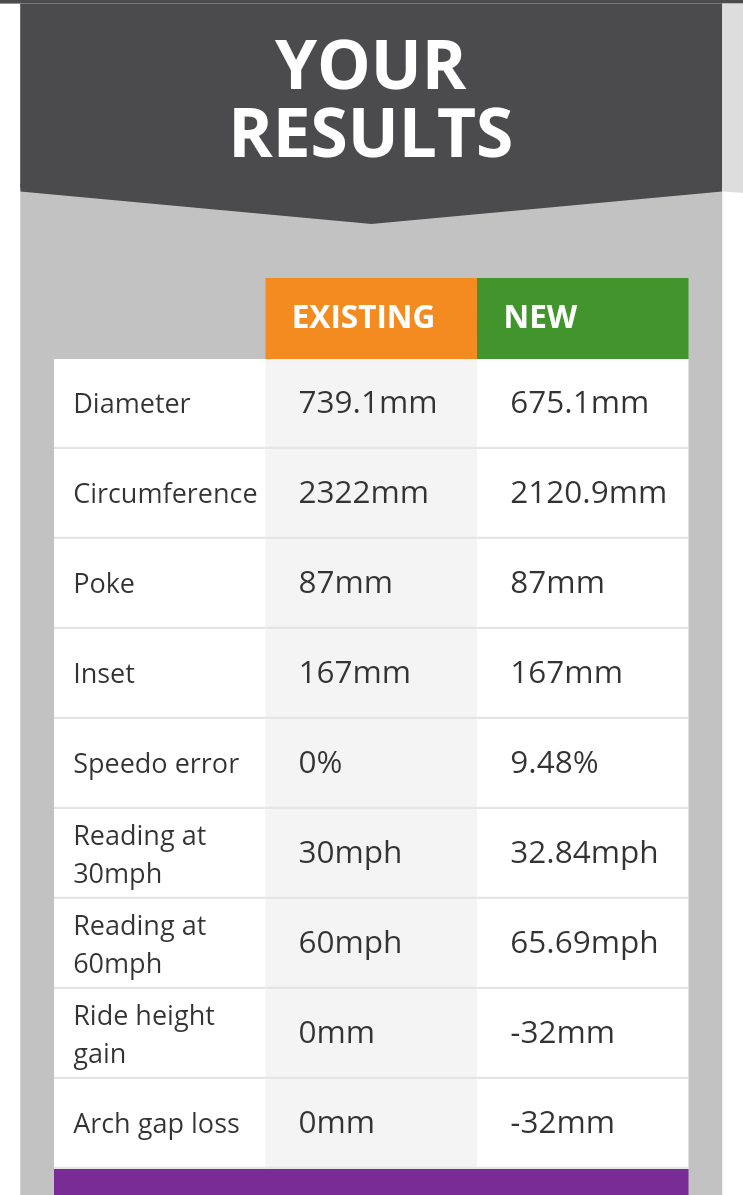

I have some new Vredesteins Wintracs on E63 rims that could be used (on appropriate rims) on my X6 but the profiles are unsurprisingly different.
What i have are 245/40/19 on 8.5j rims and 275/35/19 on 9j rims. These will of course fit 19" X6 rims, the 9" square winter set up or the staggered 9 &10j summer wheels option.
Internet info suggests speedo errors of circa 5mph at 60mph. If theres snow on the roads speeds of that nature are unlikely so not a real issue. A ride height drop of circa 30mm may generate some transmission issues though, or maybe not?
Tyres! How much leeway do we have?
