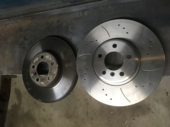

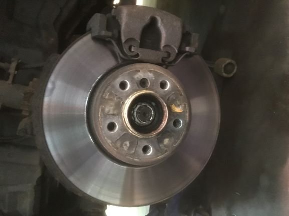

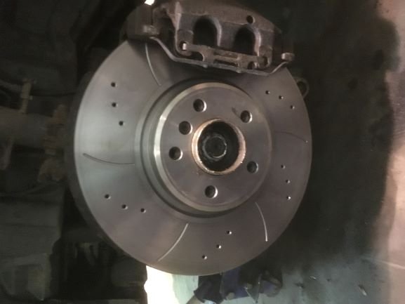

with my mot fast approaching and my x5 suffering from brake judder time to fit new discs and pads picked up some mtec discs and pads at a good price , when they arrived it was then i found out that my car falls right on the change over period for front brakes being fitted with the smaller 332mm not the larger 356mm i had brought so i opted to change the calipers aswell to upgrade to the bigger brakes , heres a pic showing my old and new discs and a before and after not sure why its flipped the last two pics

need to paint my calipers but cant decide on a colour , the only thing i did find surprising was my old pad that had the wear sensor on it was the most worn pad down to less than 3mm but the sensor was untouched , so how low do the pads need to be before the warning comes on my guess is almost metal to metal :o

How was the brake judder post fitment?

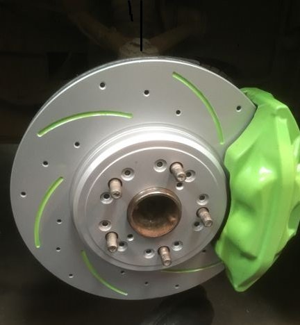

no more brake judder , i also have the matching discs and pads for the rear but will put these on once its moted , as for blue and red not sure thats for me heres a pic of the calipers i have on my other car :D

Eco Green or maybe a Ford.
Porsche put them on their Hybrid cars
not on a V8 X5, You need anti Green. :)
Tasty slots. I like those. :thumbsup: :thumbsup: :thumbsup:

they are on a V8 not a X5 but my V8 toyota soarer i do like the bright colours :thumbsup: i have considered yellow , purple maybe bronze :shifty:
