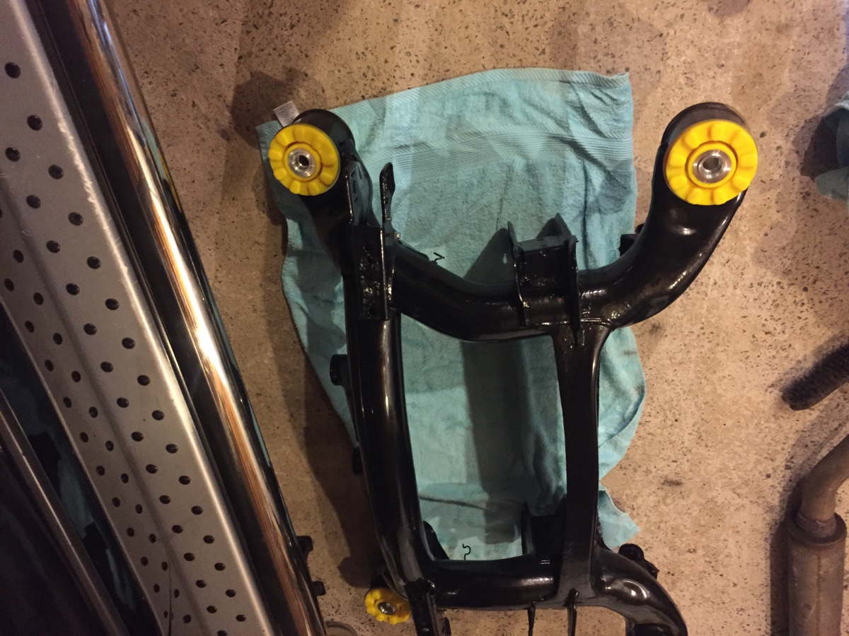

Post by henrym3 » Thu Nov 15, 2018 6:11 pm
Out with the old and in with the new, well refurbed.

Nice one Henry. I did not have the tool and had it done by a garage when I had the rear bushings done.

That's made a nice job of it , I did notice quite a bit of rust on my e70 rear subframe and it isn't even 10 years old yet , don't fancy taking it out but will maybe apply some waxoyl to stop it getting any worse.

As you can see the mounts are polyurethane and just fit in by hand, I’m a fan of the stuff and every bush on the X5 is now polyurethane. There was other little faults that showed up when the subframe was removed, the area around the diff breather was quite oily, caused by the breather rubber pipe being trapped between subframe and body. A stupid little 10p clip was broken allowing the ride level sensor wire to move about and had rubbed through wire coating and presumably in the not to distant future I would have had problems with that, broken exhaust hanger.
This weekend I need to find somewhere in this area that has a Hunter wheel alignment machine, will allow me to be in there and watch, will set the suspension to MY settings and give me confidence that they actually know what they are doing.
As I now have a spare subframe I had thought of getting it blasted and powder coated and then sell for £200 the reason for this thinking is that there are lots of rusty subframes for sale so this would be different, do people think this is a good/bad/stupid idea.
