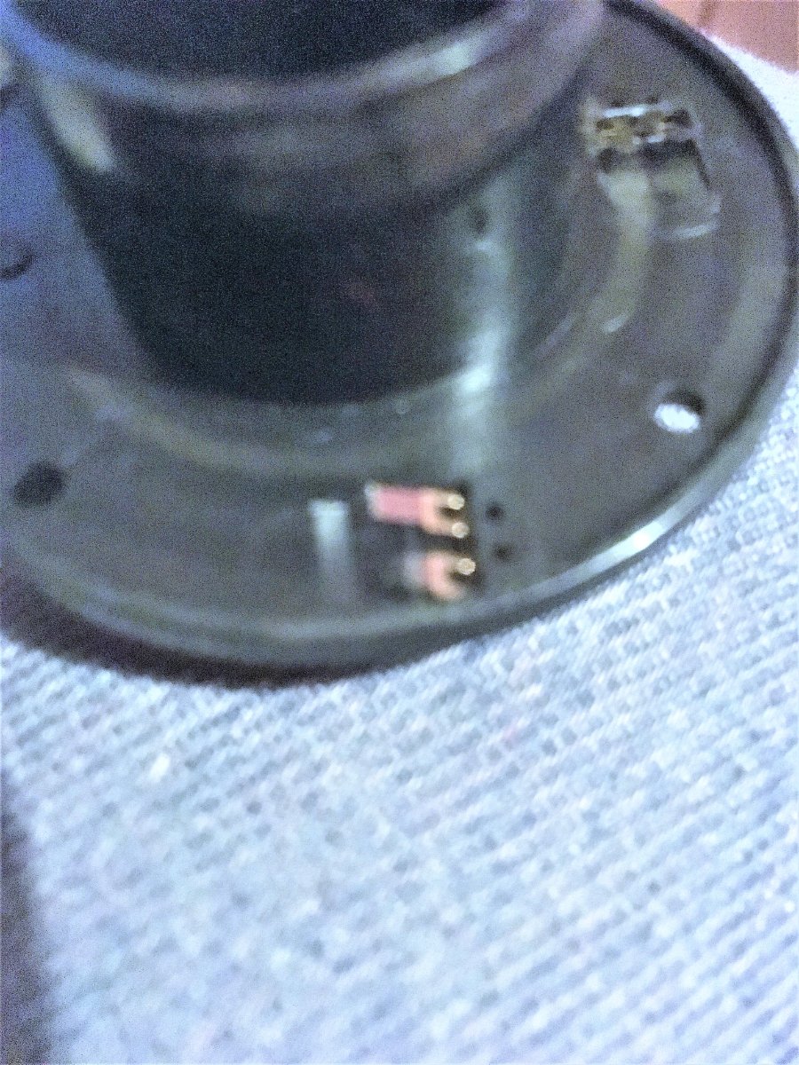

Being the curious type i decided to take my old sensor apart see what was going on inside and found this sorry not the best pic if you look at the bottom of the pic you can see two contacts well one as one has worn away hence the fault .
