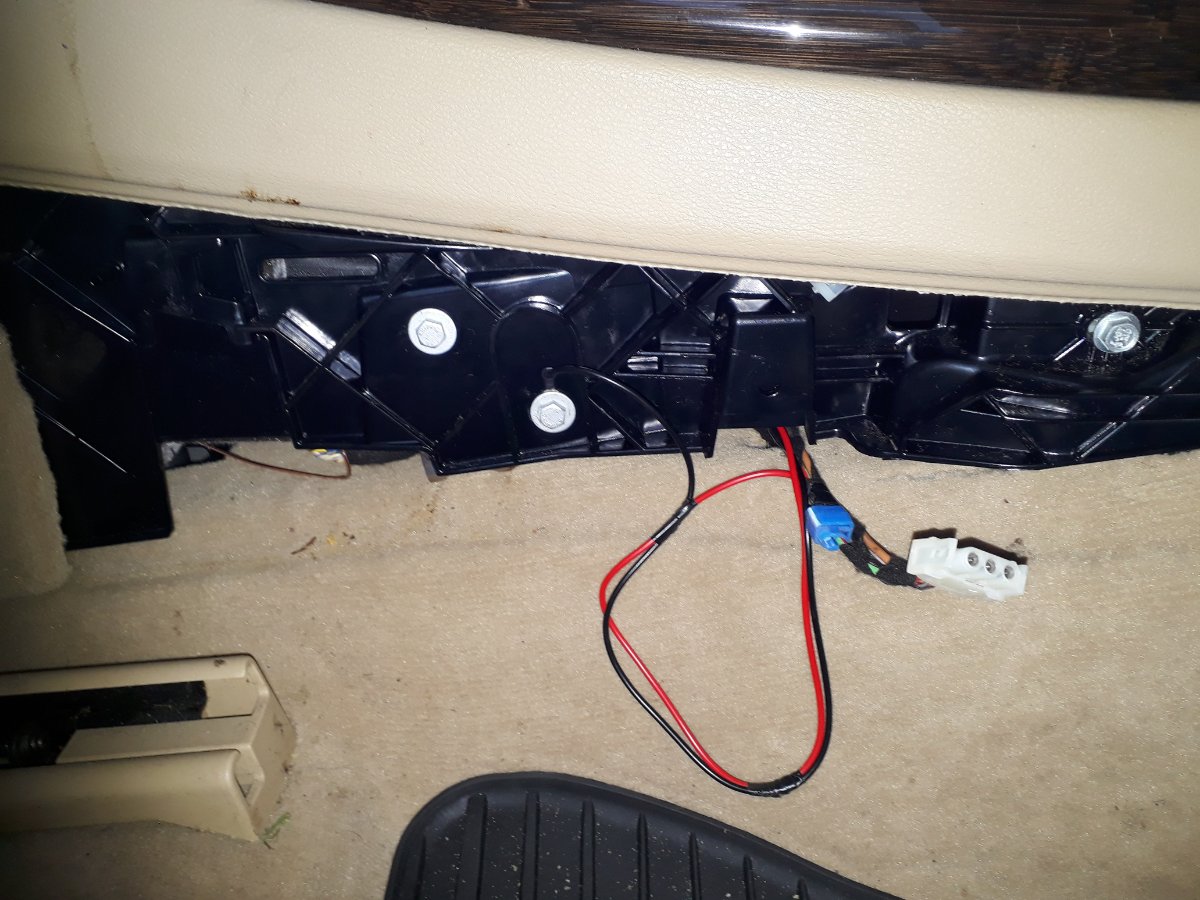

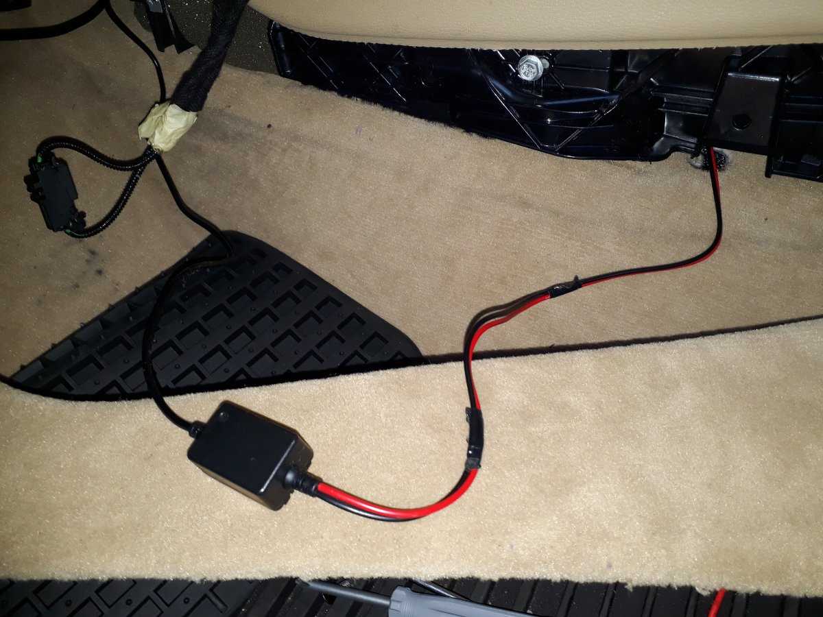

- Posts: 1654
Re: Dash Cam
Pics:
I went along the headlining down the pillar airbag then down behind the door rubber , across under the fuse box( 3 star screws to remove ) , along and then under the center console trims to the drivers side where I spliced into the cigarette lighter loom plug with a scotchlok connector .When its all done you can't see any wires .The console side trims need a torx screw removing ,one for each trim.
