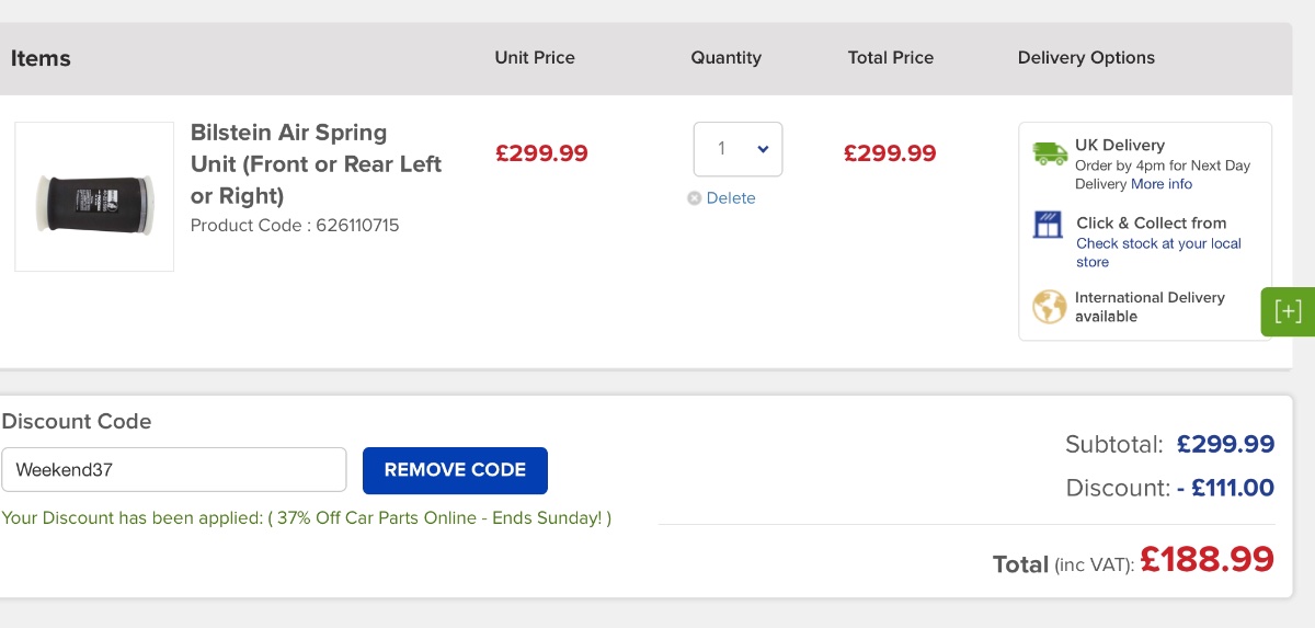

Just reserved bilstien one from eurocarparts
37% off so £189
Can always return it

Arnott is about £160 or bilstein I can pickup tomorrow £190
Arnott or bilstein?
