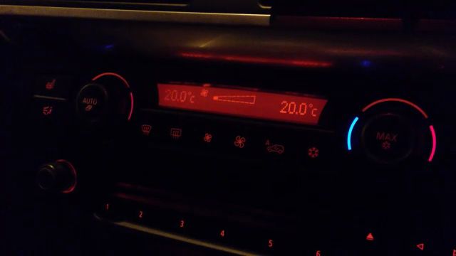

It's been a year and didn't get to the bottom of this noise
So to recap my heater makes a humming constant noise when above around 25degrees and between 22-25 there's a faint pulsating, thumping noise
Below 21 degrees it's faint and goes away more the lower the temp
Here's a video of it
More apparent at 30 seconds onwards
Warning - need volume up to hear!

Hmmmmm.... that doesn't sound right to me. Sounds like something caught on a fan as it spins perhaps, but I wouldn't know where to start looking. You can buy a used climate unit on ebay for around £120 so if thats the problem not too hard to sort.
Perhaps free the climate unit from the dash but leave it connected (so hanging out of its hole) and put your ear right on the top of the unit to identify if its the unit or not?
